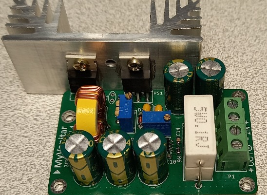

you can see this project very help full. buck converter steps down the input voltage while it increases the output current. a DC to DC buck converter that can be used effectively as a switching power supply.
